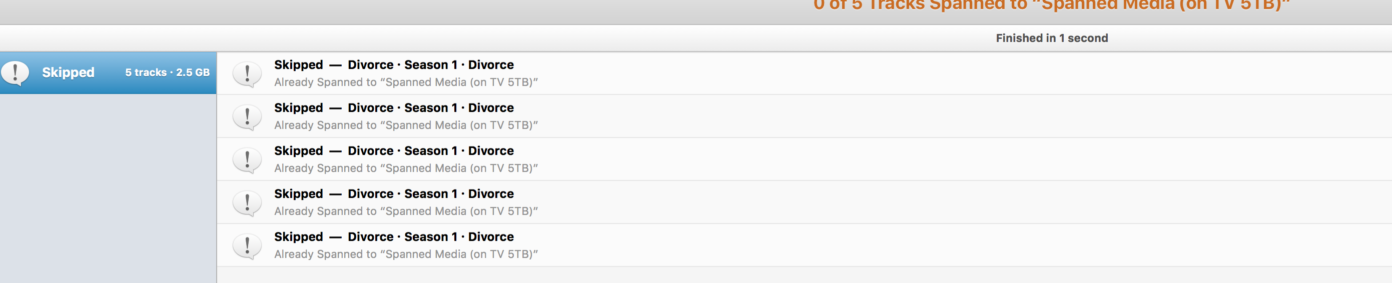

Attached screenshot.
When I do a span, this is what happens (attached) and beeps saying 0 of 5 tracks spanned.
The error message says they are already on the spanned drive (which they are).
They play just fine on iTunes. But continually get these skipped errors.
When I highlight and click "force" I get a soft "clunk" sound.

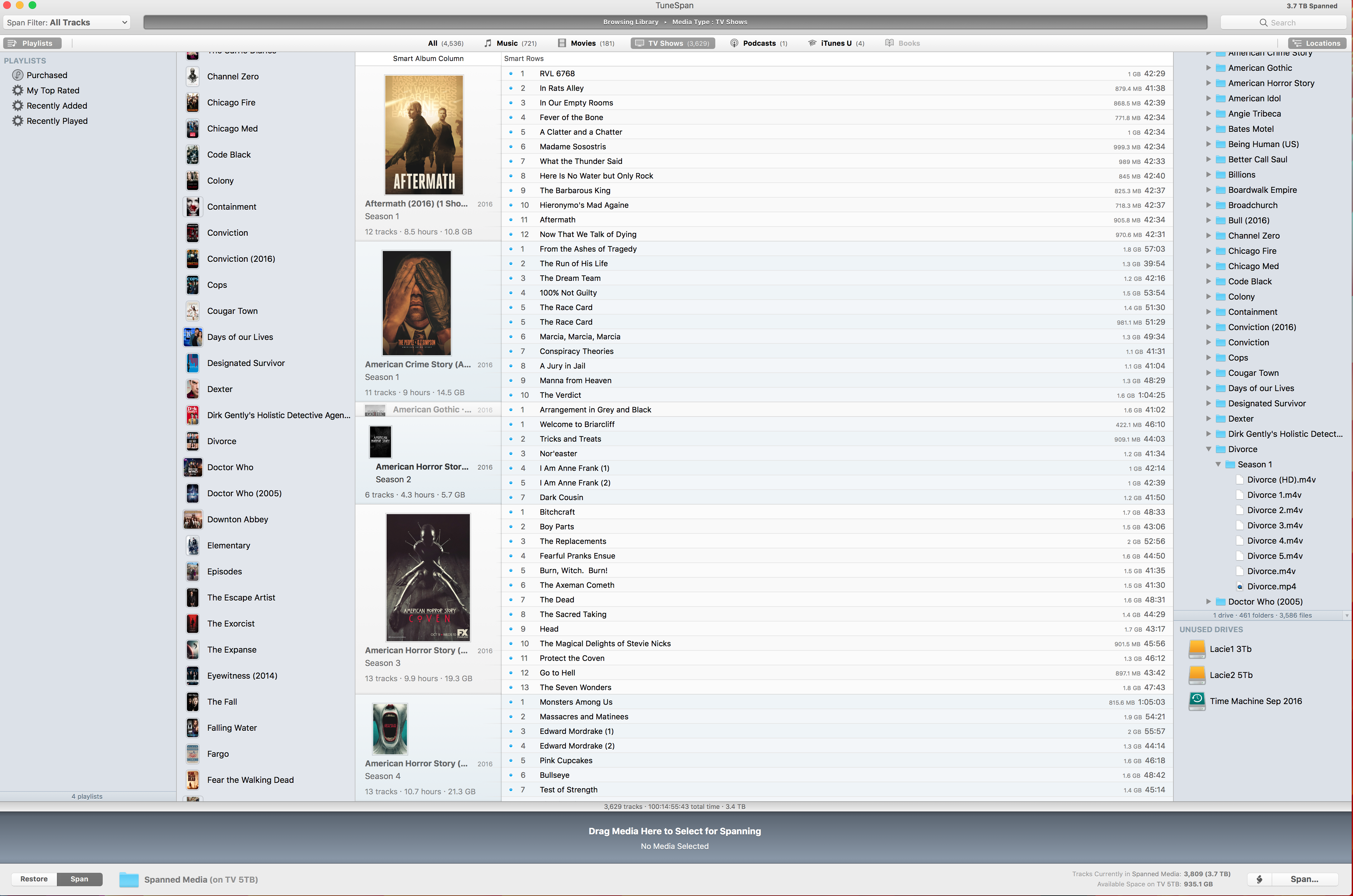

Not entirely sure if this is what you mean but have taken a snap of the entire app. Can see Divorce on the left and on the right under spanned.

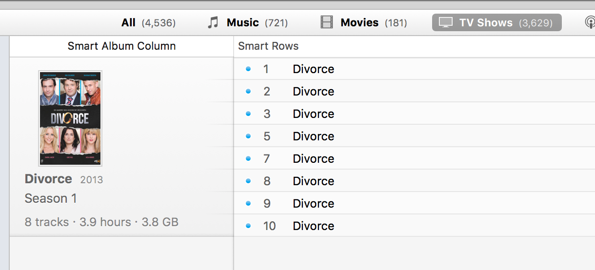

Sorry for the misunderstanding. Need to see these tracks in that main list in the center of the window to see whether or not they have the blue dots like the rest of the tracks in the list. Could you scroll down to them and send another screenshot?
Please accept my apologies Pico. Yes they all have blue dots.
Everything has been spanned and has blue dots.

You're first screenshot of the TuneSpan window showing the different filenames give more evidence of this situation. It's the files whose names have " 1" - " 5" appended onto them that are having the issue.
