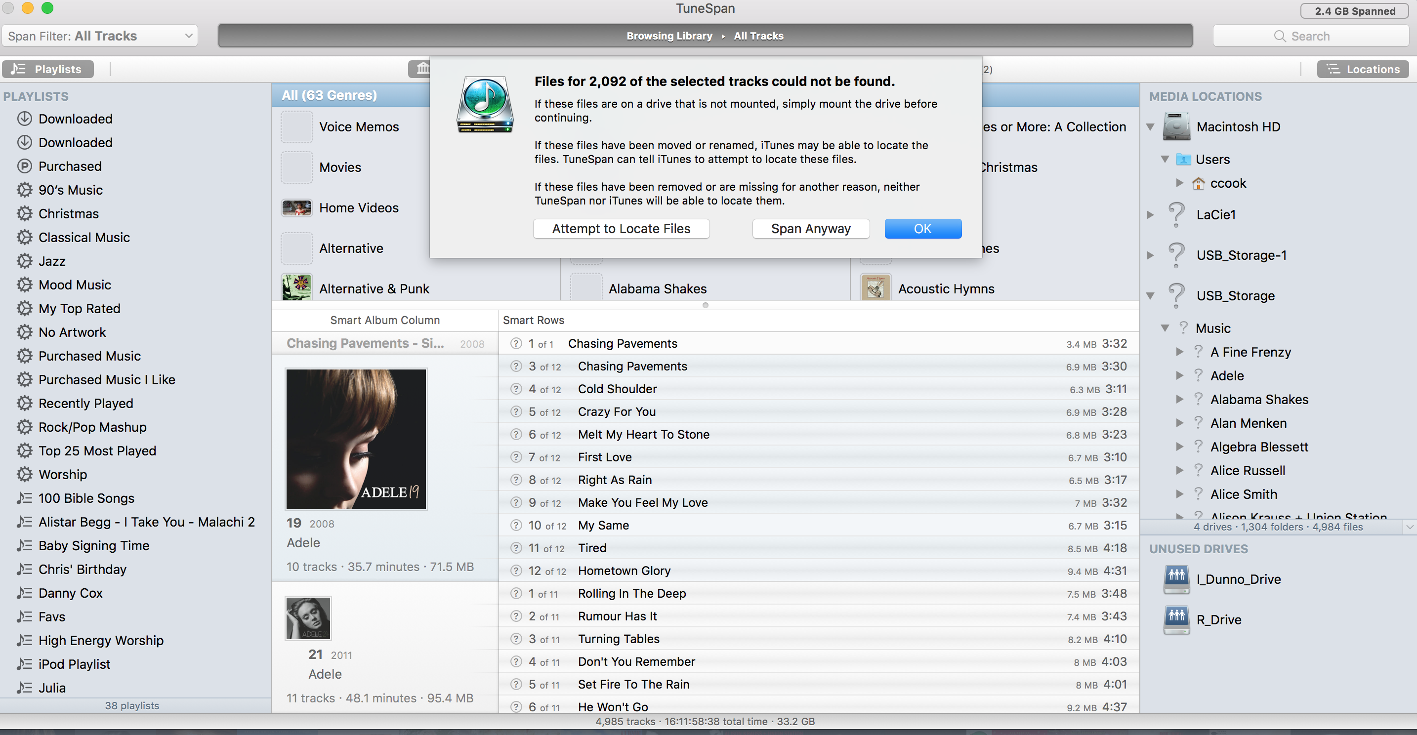

I have the same situation - moving from USB_Drive (which failed) to the new R_Drive. (see attached screen shot).
I chose the "Music" subfolder on the R_Drive as my span location. That's where I put the media from my recovered drive.
I have followed your instructions as best I understand them and a pop up box comes up (see 1st screen shot). I tried "Attempt to Locate Files" and it failed because they weren't found.

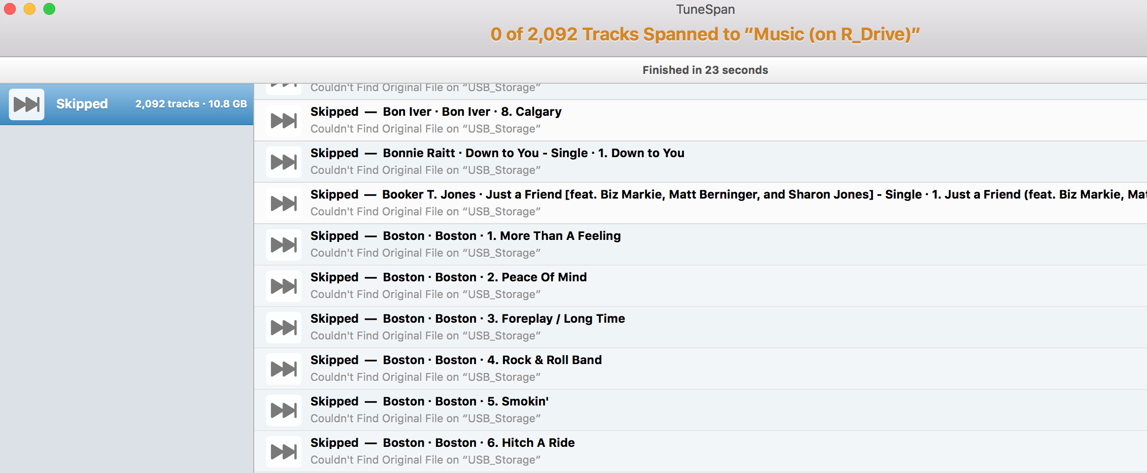

I tried again and chose "Span Anyway" and all were skipped (see second screen shot).
What am I doing wrong?
So sorry I didn't get back to you sooner. From these screenshots, it looks like you need to set the Span Location to "R_Drive" itself instead of the "Music" subfolder. This is because TuneSpan creates the "Music" subfolder when it spans so when you set the Span Location to the "Music" subfolder, its looking for another "Music" folder within that.
