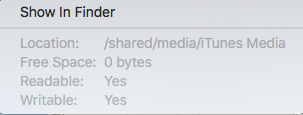

I'm starting with adding "File Access" to the required span location of "/shared/media/iTunes Media" which is a directory located on a NFS share (mount point: /shared/media). That directory is owned by my user and full read/write access is given.
However, adding that "File Access" seems to have no effect other than it being listed under "Locations access this run" with a details popup showing again the 0 bytes available (see attached screenshot). It is not listed as a span location, and even choosing it explicitly as a new location shows absolutely no effect or error.
Could you please fix this, or make TuneSpan more failure tolerant!? I actually don't care if it shows "0 bytes available", if it just would use the directory.

Firstly, about adding the folder via the File Access menu not adding it as a span location, that is normal behavior. The File Access menu is just that. A record of what TuneSpan has access to and an advanced way to grant TuneSpan access to specific locations. It's an advanced usage menu, not intended to be how Span Locations are selected. To set a span location, drag the folder onto the Span Location area from Finder, or click the Span Location area and use the popup menu.
TuneSpan is currently checking all the mount-points and finding the highest level mount-point that the folder it is examining resides in.
Would you mind sending the current full output of "df -k" so that I could see all of your mount points? It may help me understand what TuneSpan is doing wrong here.
