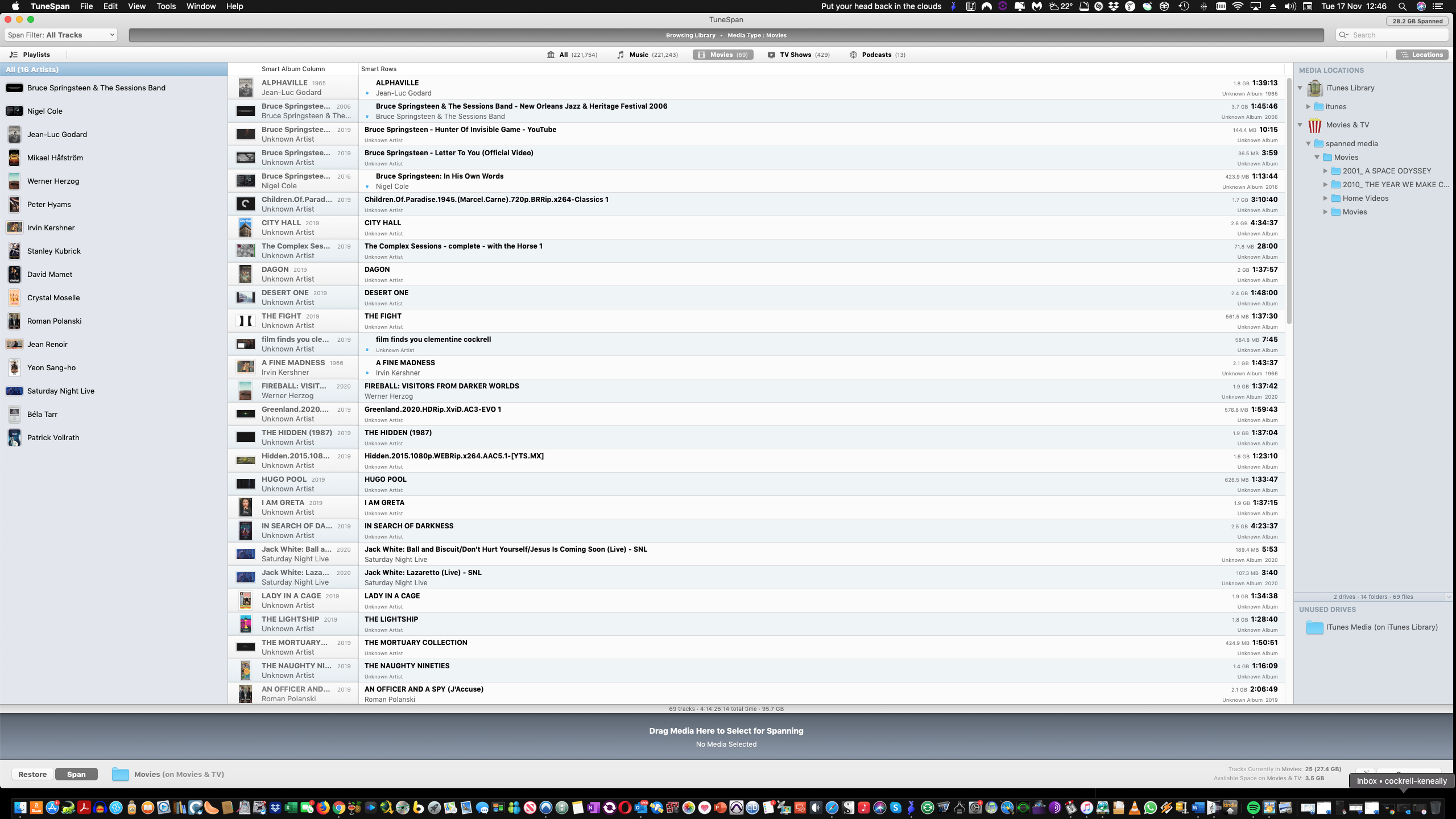

How to explain this? The media files in question, which is those that used to be viewable in itunes after being spanned to the WD external hard drive, don't now show up in Tunespan--but they're all still intact and available on the external drive in the folder structure set for them. If that makes sense.
The only movie files viewable in TuneSpan at the moment are those I keep in a queue under the Home Videos section in iTunes (version 12.9.5.5). I do this because I span them when I movie them from Home Videos to movies, and since the external drive is so crowded I have to delete something before I can add something, if this also makes sense.
In any event, here's a screen shot of what's currently viewable in Tunespan. Please note that the iTunes library itself is on the external drive iTunes Library (also WD), and the files in question are on the WD external drive named Movies & TV.

Thanks for this extra info and screenshot.
So it sounds like somehow the tracks in question were removed from iTunes. That is odd and not something that TuneSpan has the capability to do, so I'm not sure how that would have happened.
But, you can easily add them back to iTunes from their current location without having to copy anything back and forth.
To get them into iTunes without having them moved to your default iTunes Media location, you can go into the Advanced iTunes Preferences and turn off the "Copy Media to default library location when importing" option before dragging your media into iTunes. And then after its imported, you can turn that option back on for normal use.
